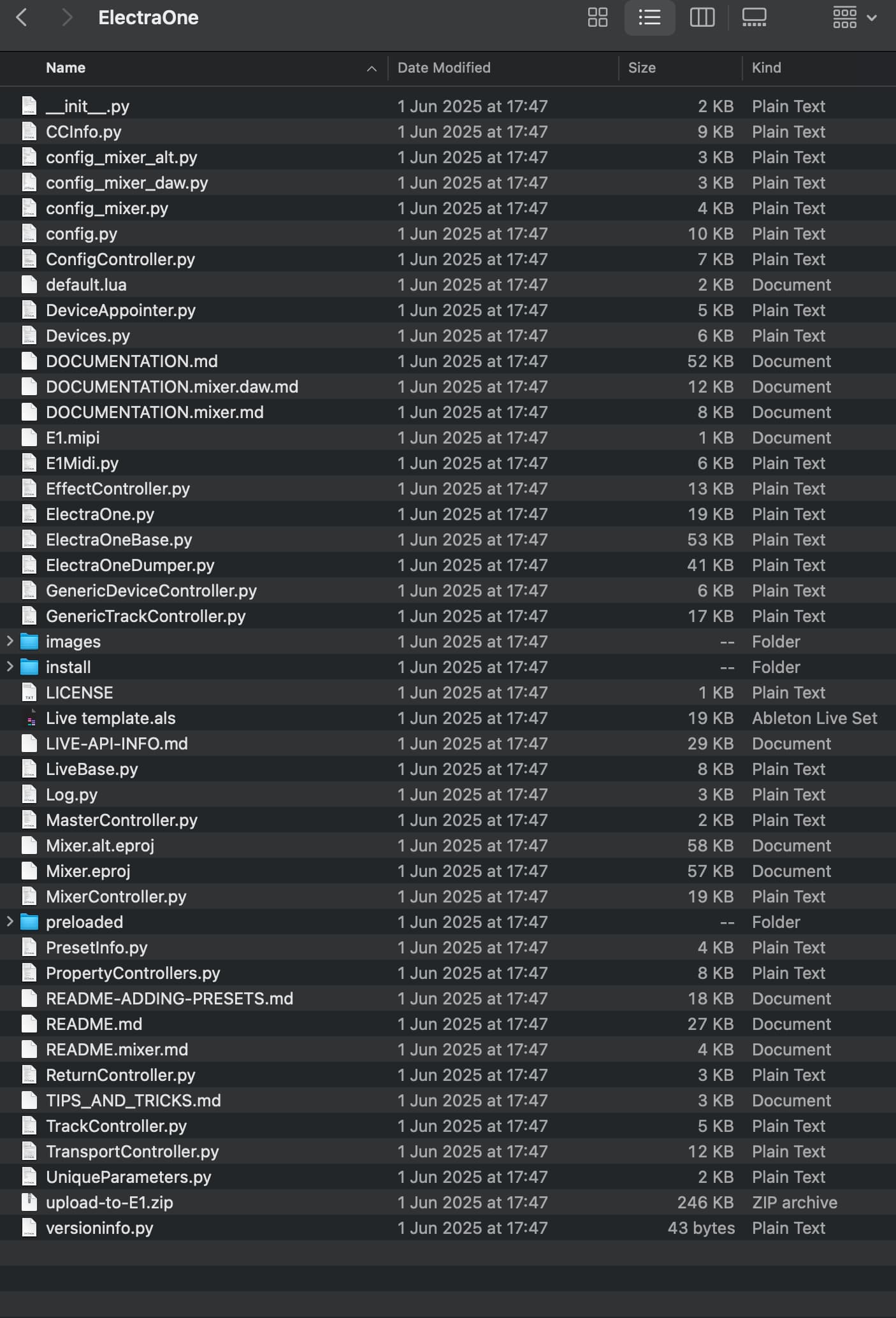

That is strange. I’m on 12.1.5 as well and this is the path the remote script is in for me. Can you send me a screenshot or listing of the contents of /Users/stephankerkman/Music/Ableton/User Library/Remote Scripts/ElectraOne ?
Sure!
That looks as expected. Can you send me the logfile? I.e. /Users/stephankerkman/Library/Preferences/Ableton/Live 12.1.5/Log.txt

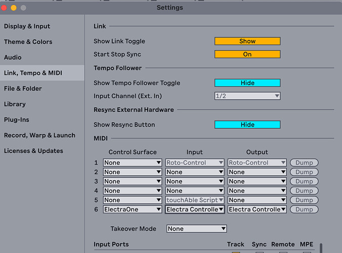

Im trying to make this script (the new one) and Ableton 12.1.10 sees the remote control script in preferences, I can select it ands I have setup the Ins/outs as per the manual.
Unfortunately I dont get anything to work.

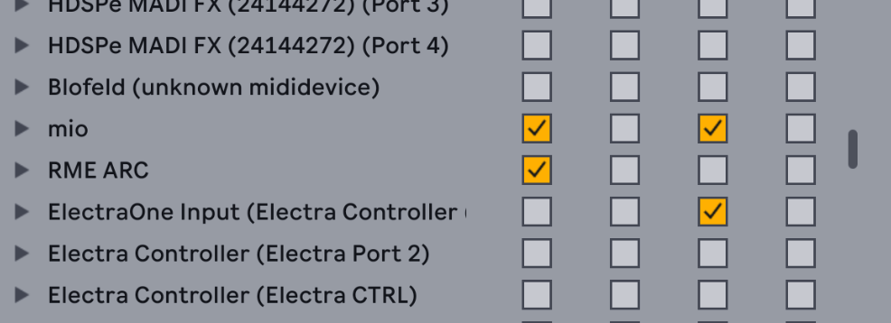

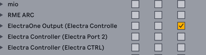

Please make sure you select port 1 of your Electra both as input and as output port for the ElectraOne remote script. (I’ve updated the readme to try to make things clearer).
If you still can’t get it to work, sure you can send me the log file if you want.
P.S.: This instruction is for MacOS. On Windows, the port you need to select is simply called Electra Controller (the other ports that are not used by the remote script are called Electra Controller (Port 2) and Electra Controller (port 3)

Yes, I have the surface control setup for Port 1 as in and out, and on the midi as remote only.
