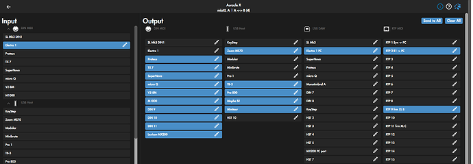

good question. I resolve this via a MioXL router:
  • the direct USB connection between E1 and PC is solely used for editing presets.
  • all MIDI-traffic to and from the E1 is done via port 1 DIN MIDI into the MioXL MIDI router
  • that router is connected to the rest of the gear but also to the PC via RTP MIDI 1 and 2.
  • The Electra 1 (connected to MioXL DIN MIDI 2 here) routes its info not only to the synths and the second and third MioXL (via RTP Midi 9, and eventually 11), but also but to the PC on RTP Midi 2.
  • any other synth, such as the Matrix 1000, is not only routed to the E1, but also to the PC via
    RTP MIDI 1.
In other words: while the synths and the E1 are talking to each other, they also sent the same info to the synth for Midix-Ox to witness. But as this happens on a different port than the E1 programming port, I circumvent the lack of “multi-client” mode a PC has.

But if you have a mioxl and their drivers installed you DO have multi client capability
Via USB , you mean? I’m no longer USB to PC connections on the Mio but RTP-Midi: the Mio’s interconnect as well when the PC is down (my PC not always turned on when making music).
But I do recall when I used USB it did show as multiple MIDI devices in my DAW too.
I can confirm that the MioXL MIDI ports in Windows 10, both RTP and USB, are multi-client capable. It was the first thing I tested when they arrived.
All endpoints on the Mio are multi client capable, rtp, din and usb, but you have to use their driver

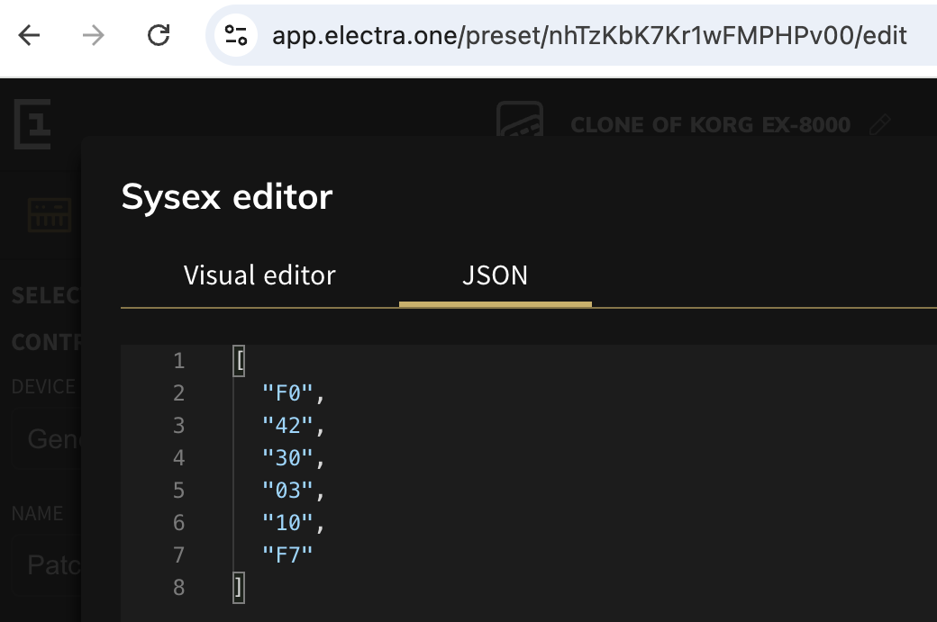

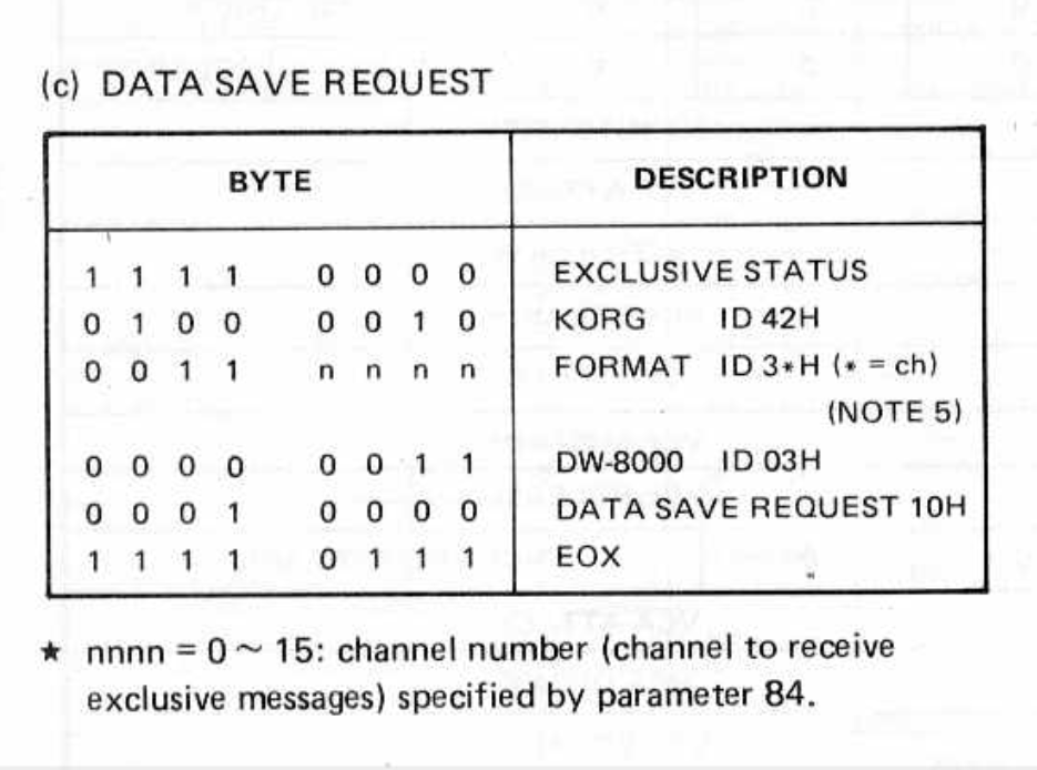

@NewIgnis : Will to try to follow the whole tutorial more but so far I was able to create a momentary patch request button for the Korg EX-8000.
As I’m on a Mac I checked with SysEx Librarian that the EX-8000 responds with a dump of the recent patch.
Would you now recommend trying to include the routine you mentioned to make sure any MIDI channel will work?
Sorry for being at the very beginning of things here!
No, I would not.
I found that the listening function has a hard time to detect the right SysEX question and Response if they contain variables. Add the variables only at the end.
What I would propose: keep both questio sysex and reply header hardcoded (as in your example), check that the synth does respond, and now make sure via the listening function in the E1 editor, you see the reply coming in, ready to be parsed.
You then choose a patch for which you set up at least 3 parameters on 3 different values, known to you (for instance put VCO1 level on 3, VCO2 on 6 and Noise level on 9).
Then request that patch and in the webeditor check for yourself if you find those 3 values on the places you expect.

I managed to find changes with three parameters so far using the Sysex Librarian… Will now try to see how to proceed with the receiving and sorting in the E One.
