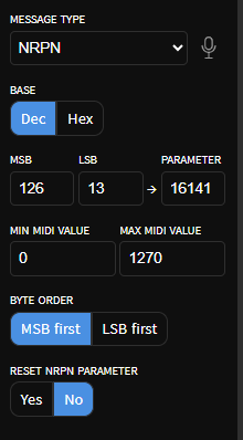

It is foreseen in E1 without lua:
For NRPN you have 2 parameters you can set:
  • Byte Order changes whether CC38 is LSB or MSB (so that is what you are looking for)
  • Reset NRPN determines whether you need to resend CC100 and CC101.
In the next 4 examples I’m sending value 3:
Example 1
Example 2
Example 3
Example 4

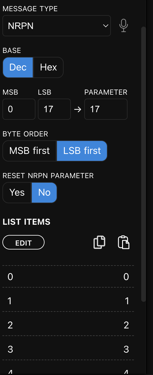

I made an option list with the values 0-9. When I turn clockwise, the value alternates between 0 and 1, i.e. 0, 1, 0, 1, 0 and so on.

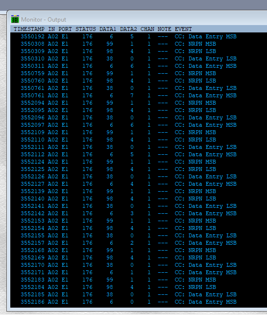

I have tried all 4 variations and none of them work. My LUA code works. Check out the following picture.
I don’t see the difference between the behaviour of your example and my example no 4.
The difference is that my version doesn’t output 0, 1, 2, 3, 4, 5, 6, 7, 8, 9 when I turn the pot clockwize. It outputs 0, 1, 0, 1, 0, 1, 0, 1, 0, 1 and so on. I have no idea why. Maybe I can test your preset?
