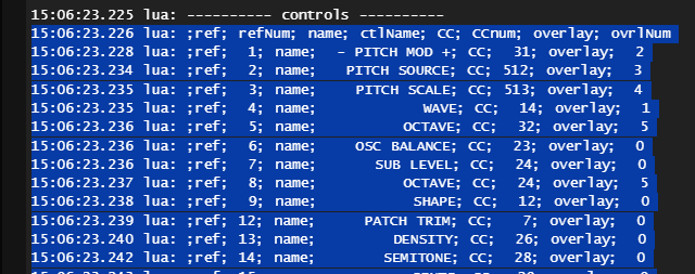

Nice work, thanks , I will certainly use this in my presets (adding at the end, usually quoted away)
I did change the print command into a string with semicolons:
print(string.format(";ref; %2d; name; %14s; CC; %3d; overlay; %2d", control_ref[i], cname, cc, ovl_Id))
and added on top
print(";ref; refNum; name; ctlName; CC; CCnum; overlay; ovrlNum")
this results in :
If you now copy and paste those lines in Notepad and save it as a csv file, you can open it directly in Excel and filter or sort on each column:
This being said, could you enrich your script further ?
It now assumes all parameters are of type CC, which they are not, so adding what parameter type they are is handy.
Adding to it the other attributes of a control (like min, max, color) or a parameter would also be helpful.
