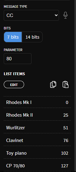

Here’s an example on how to set it up: create a new control of type ‘LIST’, copy your already made list items to it (with the symbols at the right of the encircled ‘EDIT’), and give it the same message type and parameter as your existing fader. You can then test it side by side.
