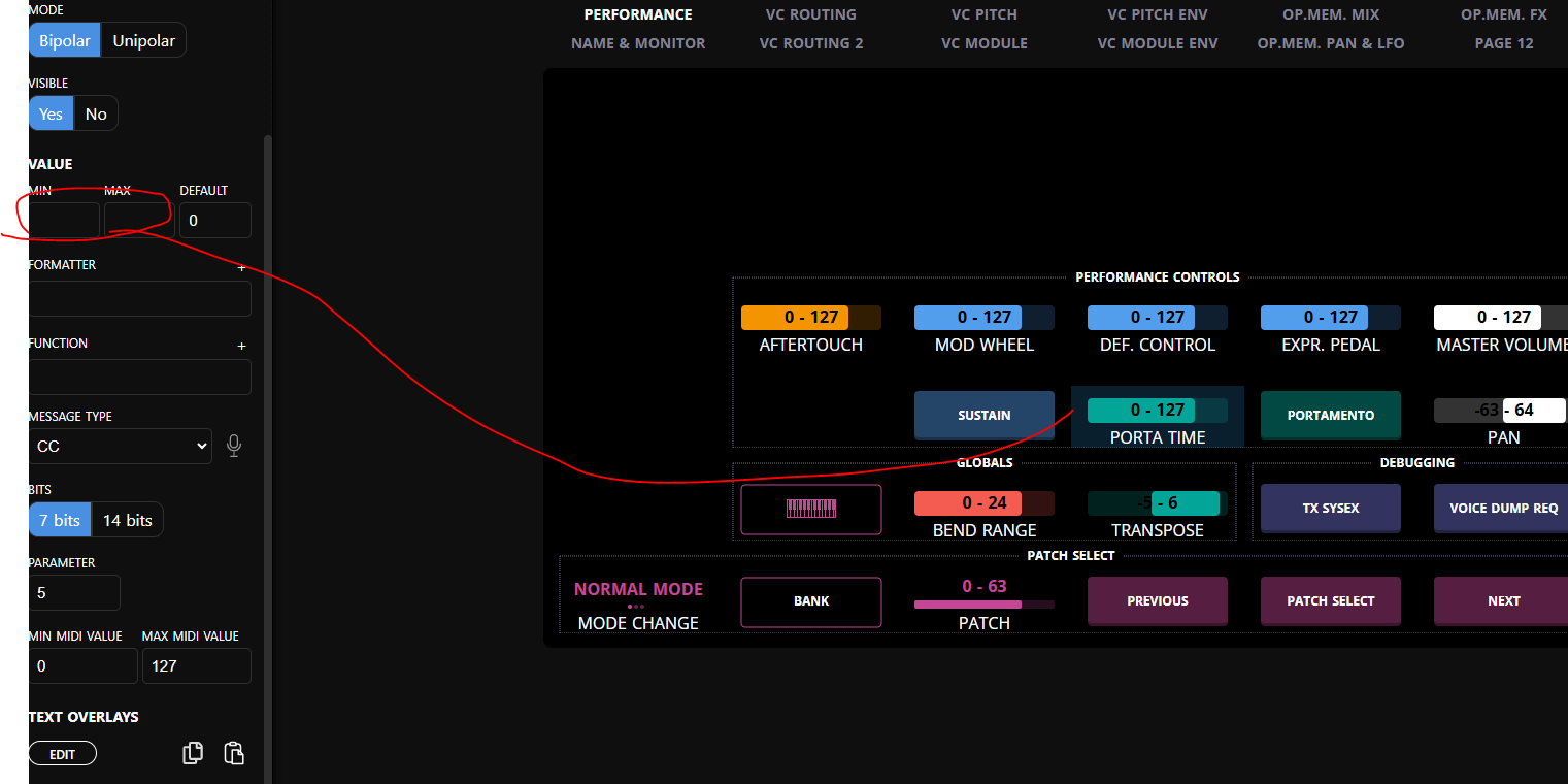

Sorry about that. I should read more carefully. I did change one thing on the preset. I changed. the scale of the portm time to go from 0-99 instead of 0-127 - just to match the range on the synth.
You mean for CC #5 you changed the display values ? I’ll do that too then in the next version.
