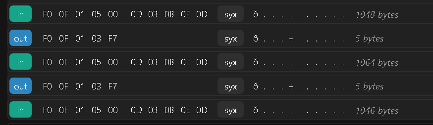

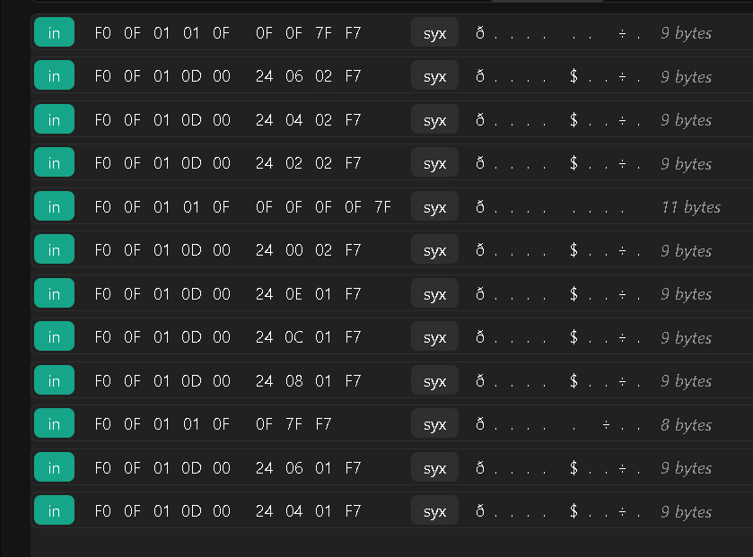

Hey Thanks a lot. I am doing some testing.
- Value send test
We put the filter freq [36] on Value 20 and clear the monitor
We spin back to 0 quickly.
The display shows 10 now…
I count all the arrow down bytes… And see only 10…
So does the Eone send only 10? Is the Mirage not so old in the brain after all?
We put the filter freq [36] on Value 32 and clear the monitor
The display shows 12 now…
Hmm the webapp debug logs are too short so i re-did this test using the console app.
And got again 12 on the display … so there is some consistency in the behavior.
Counting the bytes from the debug log we get 22 down arrows and 2 up, so 32- 20 down = 12…
Counting the sysex bytes I got the same.
Testing with this template: Electra One App

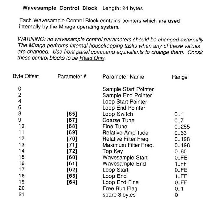

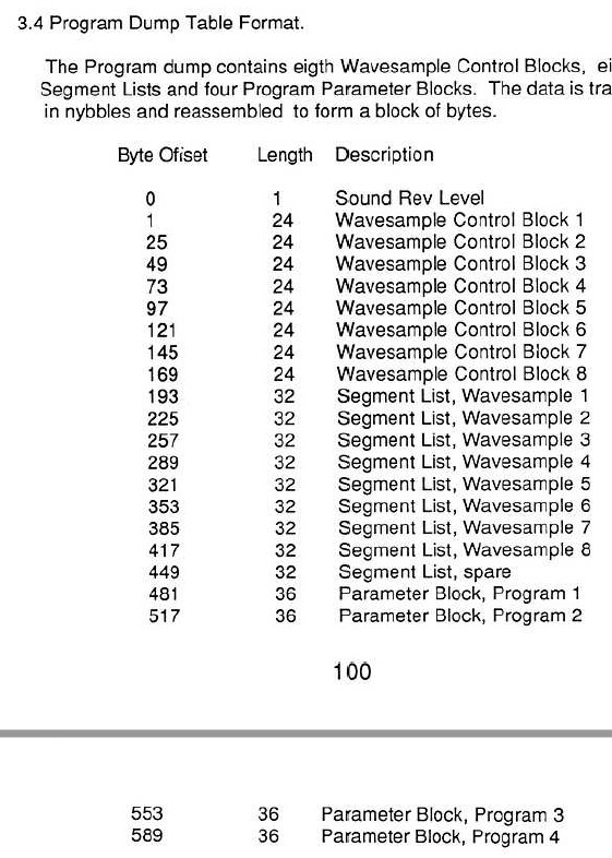

- Parameter response messages:
Filter freq parameter [36] hex [24]
we send 1 arrow up so value is 1
F0h 0Fh 01h 01h 0Eh 7Fh F7h
Response from the Mirage:
F0h 0Fh 01h 0Dh 00h 24h 02h 00h F7h
we send 1 more arrow up so the value on the panel and eone is 2
F0h 0Fh 01h 0Dh 00h 24h 04h 00h F7h
So the internal range is 00 … 198 and we have to divide the value by 2 to get the front panel value.
Header Parametermessage keyboardhalf 4bits and program parameternumber in hex value LS / MS nybble the end
