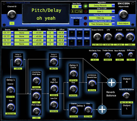

Sure, I’m working on this for standalone editing and VST3/AU/DAW automation on the LXP-5 (and possibly 1 and 15 later):
Under the dials, there are readouts of values, typically from 0-127. I do not know if the Lexicon remote just lists the range or where it adds context by interpreting what they mean. I followed the manual to look at the build of the paramters (e.g. logorithmic) and then AI to plot the curve and give me values but if you have some actual readouts, I can make it more true to the hardware.
