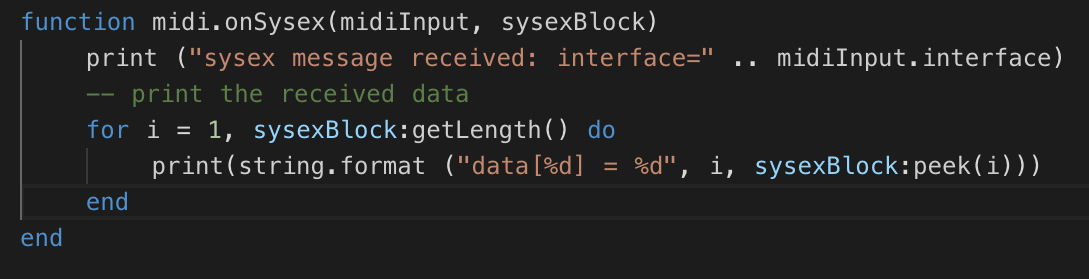

I am using the following code in LUA.
I get a strange message like this when sending a sysex dump (650 bytes) to Electra.
What does that mean, does Electra lose midi bytes?
I tested a much shorter (40 bytes) midi sysex message and then I didn’t get any error.

I have a similar problem using lua midi.onSysex, but in my case the sysex message is always corrupted from byte 49 onwards regardless of the sysex message type. For sysex messages that I know are longer than 50 bytes (usually ~250 bytes), the length of the sysex block is also wrongly reported as 50 when I use sysexBlock:getLength. So instead of getting the full block, it gets 50 bytes of which the first 48 are correct, and then I get several other shorter nonsense messages. I’ve checked the sysex data block in MidiOx and it looks fine. There are no bytes greater than 7F that might break reading the sysex block. Any suggestions what could cause this? I have the synth’s MIDI clock turned off and the electra firmware is 4.1.1.
p.s. The problem persists if I use midi.onMessage rather than onSysex.
Later: This problem arose when I had the synth connected to the electra mk II USB host port. If I connect them using a pair of DIN cables it works as it should. So maybe there’s a response/latency problem with the host port for longer messages? The synth is a Teensy 4.1 based device.

Hi Martin, sorry about the late reply, I didn’t see your message until today. I’ve created a small ino file (txt file attached) that waits for a Midi note-on event and then sends out from the T4.1 USB port a sysex block of 400 bytes containing 4 repeats of the values 0-100. If I connect the T4.1 to MIDI OX to trigger and look at the sysex output it all works just fine.
But when I connect the T4.1 to the electra host port, and use a button to send a note-on event, I can’t get the online lua editor to show any sysex response from the Teensy at all. There’s a led on the T4.1 to show that the sysex has been sent, and that lights up correctly. I’ve included the T4.1 ino src code and simplistic lua script I’m using in the attached txt file, as well as the compiled hex file for your t4.1.
If I hook up the T4.1 based synth that I tested a few weeks ago, and press a manual sysex dump from it, there is a response from the same lua script, but it gets corrupted after ~50 bytes as I mentioned previously.
In either case the host port sysex on my electra seems to not be behaving. Can you please let me know if you get the same result in case I have a hardware problem. Thanks.

@rvh @joris.roling Electra One requests 64 bytes USB packets but Teensy sends 512 bytes back. Since E1’s transfer buffers are sized to handle 64 bytes max, the data gets trimmed - resulting at around 50 “user” bytes successfully processed.
Teensy announces that it has max packet size of 512 bytes. So I can adjust everything based on that information. I think, however, when the hosts (E1) asks for smaller packets to be used, that request should be followed by the connected USB device…
Anyways, I am able to resolve in our firmware. @rvh I can successfully transfer those 400+2 bytes from your Teensy firmware:
I have a new firmware for mk2/mini ready on beta already, but I will merge this in so that it does not block you any more.
