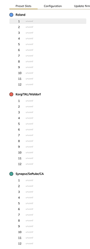

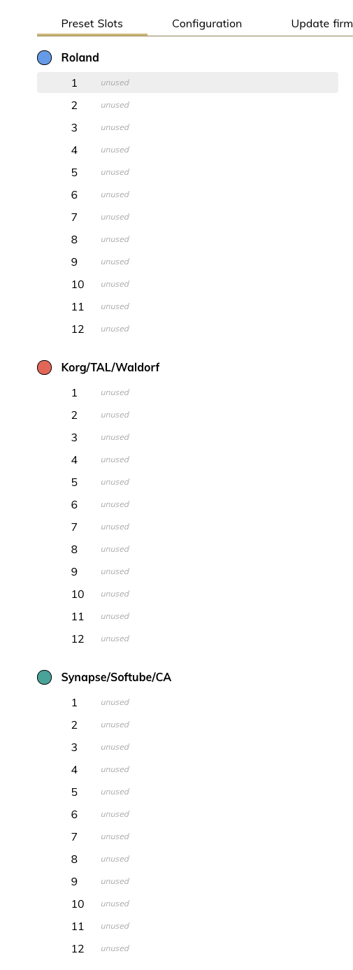

It works now. But I still have the issue that when my E1 is connected via mioXL I can’t see the preset names in the preset slots. It’s only when connected via mioXL.
