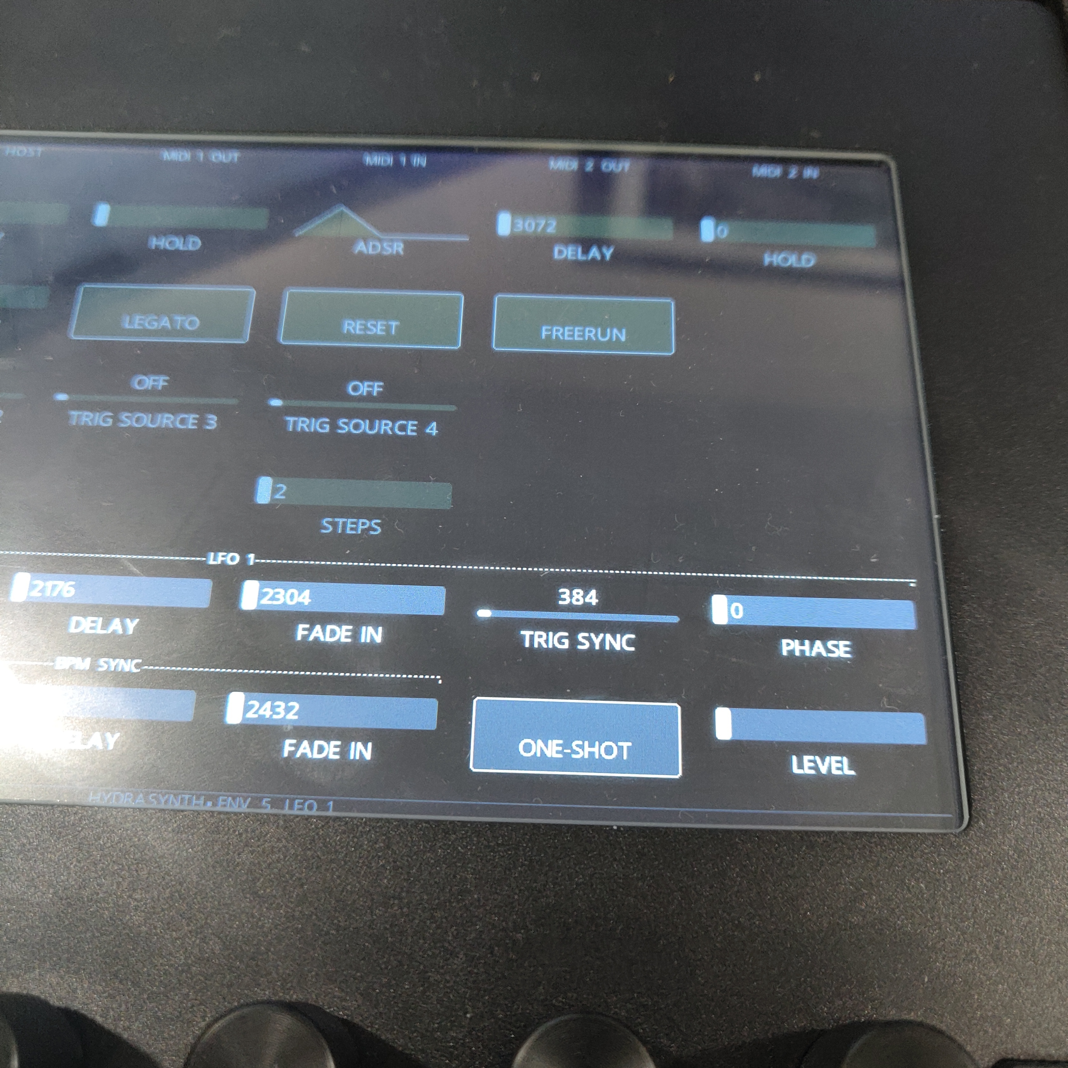

I’m having other issues that I’m not sure if it’s related to their midi implementation or Electra. Such as display issues and not being able to use overlays on certain parameters. It continues to show the midi value even though I have overlays set up. When I get a chance I’ll upload some pictures.

Here is one instance where I set the overlay and it only shows the midi value info and then display errors of showing the midi value info. Once the knob is rotated close to the end it’s like the numbers get stuck out there. I included the preset file just in case you need it. Some parameters shows the midi values like Delay and Fade In for example and some don’t like Level. Is there a way to not show the midi value?

Perfect. I found the issue with the negative 14bit messages. Will provide fix for it later today.
Edit: sorry I wrote my reply when I saw just part of your previous message. I will include these two issues in the bug fix release. Thx for reporting!
