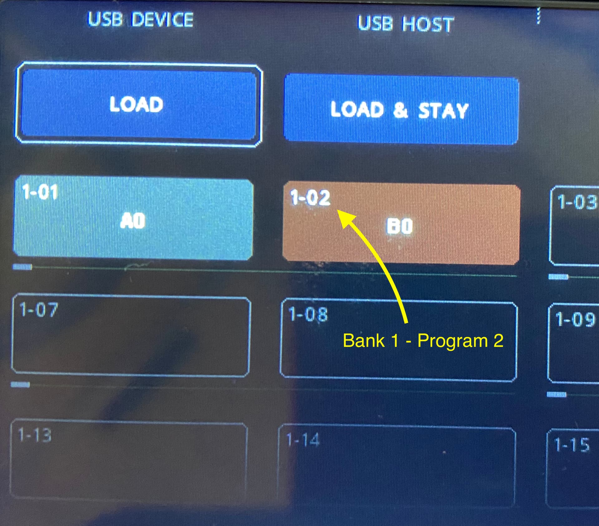

4.0.2 Electra listens to bank select and program changes on the CTRL port. Bank 0 is for the preset selections. Further banks (1 .. 12) are used to choose a snapshot bank within the current preset. ie. CC 00 00 → selects the preset bank, subsequent program changes will change the preset. CC 00 01 → selects the first snapshot bank of current preset, subsequent program changes will load and send out corresponding snapshot. Note, the bank number and program number is displayed in the top-left corner of each snapshot.

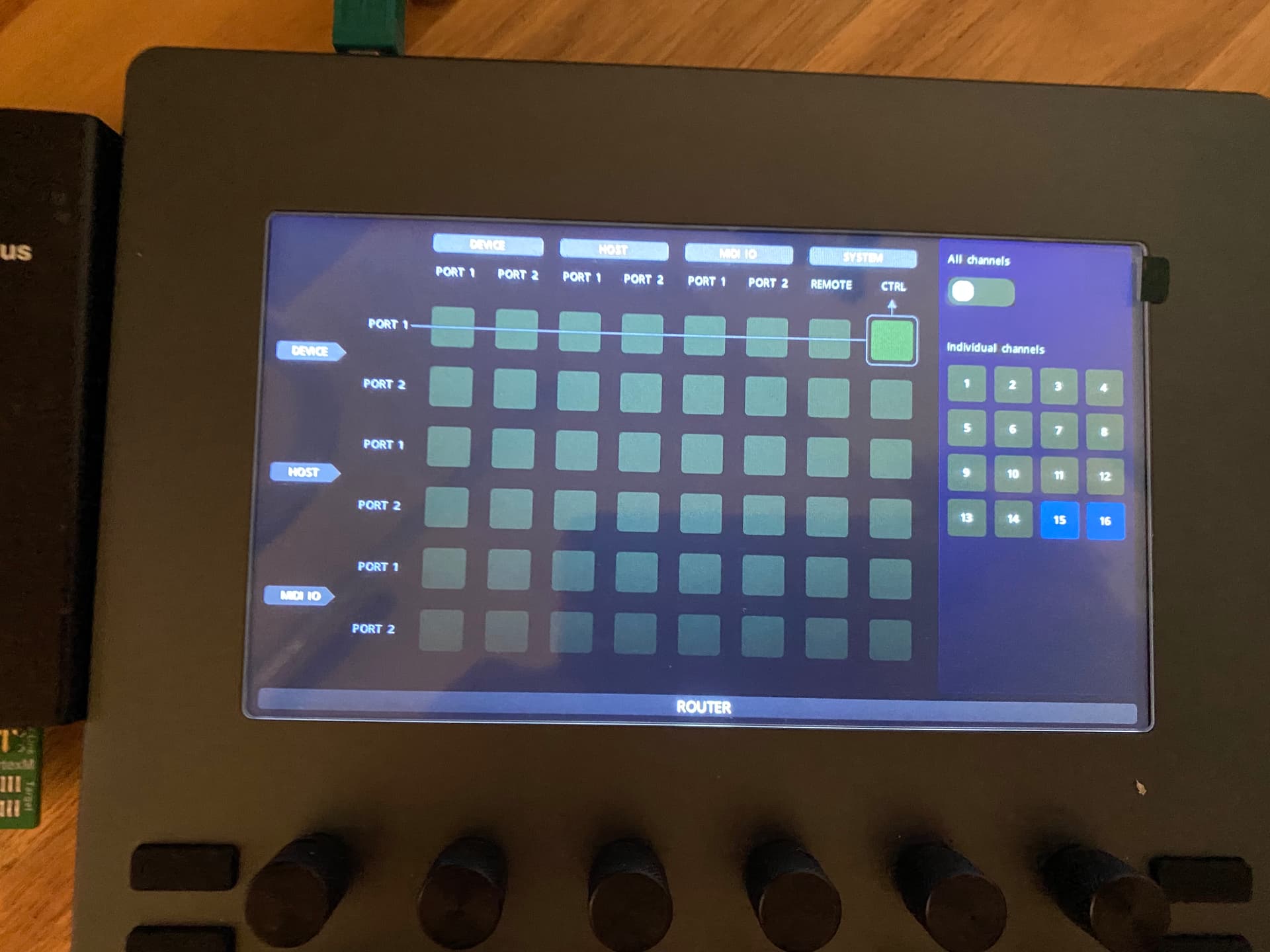

If MIDI control or Remote knobs are enabled on a Port (all channels) or Port and a particular channel, the midi messages that match that port and channel configuration are “consumed” by the those two features. Thus, if MIDI control is enabled on all channels of port 1, the messages sent to any channel on port 1 will not be passed to the preset for processing. That is expected behaviour. The 4.0.2 has the Router screen redesigned to provide information about all routings on one screen:
I would say the 4.0.2 works as it should. I guess the confusing bit for you was the 4.0.0 ignoring the Bank selects and Program changes sent to the CTRL port.
