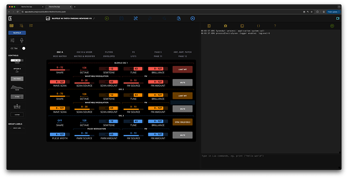

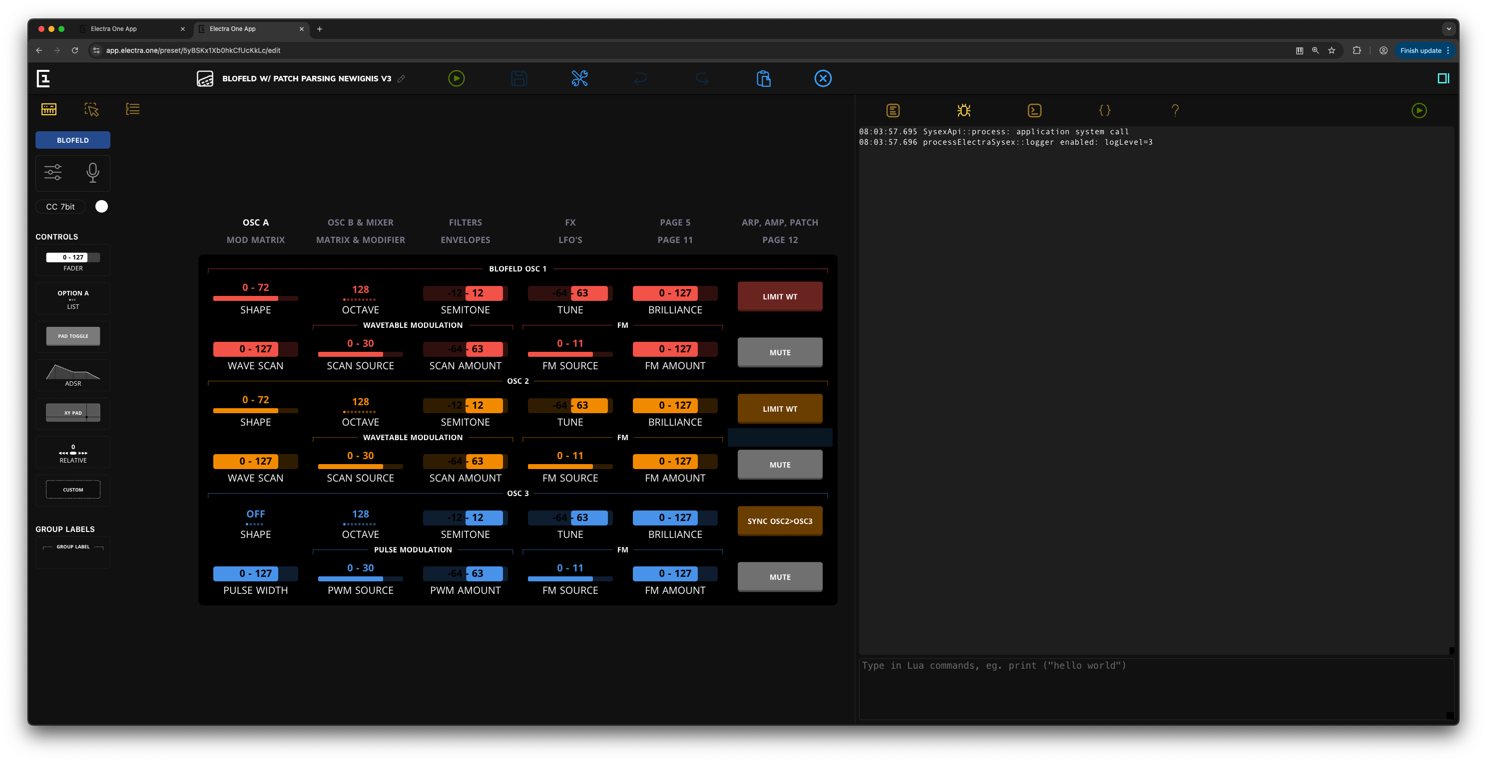

Hi,
I just tested 4.1.1 and the latest beta with my blofeld. So far, I am unable to see the issue. Would you try to capture the internal logs on your controller for me?
to do that:

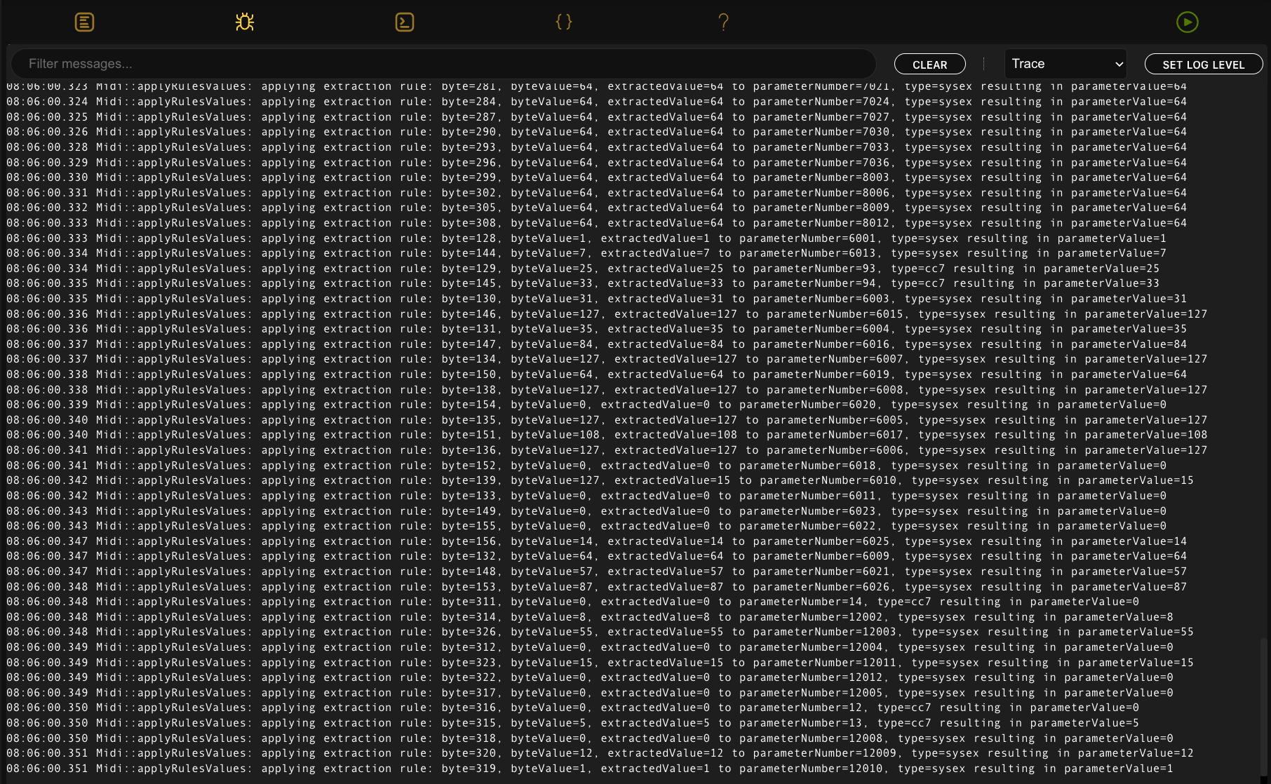

  1. click the sidebar icon in the preset editor:
  2. Then select “Trace” and click “Set log level” button:
  3. You should see this on your screen then:
  4. Now, when you press the patch request button, the controller will dump info about all processed patch dump bytes to the log window. The picture below shows the correctly processed sysex bytes (last ~40 of them). Could you check what you get there when you get an inconsistent update?

Hi @martin,
This is what I get when everything works. The Blofeld is connected to the E1 directly.
11:12:12.383 processElectraSysex::logger enabled: logLevel=3

Here is an example where the Blofeld does not respond to the patch request. I tried using the USB Hub, then back to a direct connection. It might be the presence of the Midihub that causes the issues, even after its removed and the instrument is attached directly. I will test that further.
Other Info
  • I typically have to unplug and insert the Blofeld after rebooting the the E1 as it doesn’t automatically detect there is an instrument attached.
  • I use the reboot option on the E1 between tests
11:26:27.732 processElectraSysex::logger enabled: logLevel=3

11:29:02.446 CustomWriter: cannot delete file: ctrlv2/config4.cfg
11:29:30.179 ElectraMidi: processMidi: Control change midi message: parameter=27, value=100
11:29:30.380 ElectraMidi: processMidi: Control change midi message: parameter=27, value=112
11:29:30.705 ElectraMidi: processMidi: Control change midi message: parameter=27, value=100
11:29:30.804 ElectraMidi: processMidi: Control change midi message: parameter=27, value=88
11:29:31.205 ElectraMidi: processMidi: Control change midi message: parameter=27, value=76
11:29:31.505 ElectraMidi: processMidi: Control change midi message: parameter=27, value=64
11:29:45.447 Config::getUsbHostAssignmentPort: product match: productName=Blofeld
11:29:45.450 Config::getUsbHostAssignmentPort: ports defined: productName=Blofeld
11:29:45.451 USB port: 0, name: Blofeld -> to port: 0
11:29:45.452 Config::getUsbHostAssignmentPresetId: device=Blofeld, presetId=255
You can see me testing the midi communication, there are CC msgs comming in, yet the patch request doesn’t reply.
I obseved that sometimes pressing the patch request button results in none of the IO ports flashing on the E1 with no values in the debugger. Also, the IO indicators do sometimes flash with also with no values shown in the debugger.
11:53 am: The E1+Blofeld are now in the state where bidirectional midi is working but the patch request does not work. The IO labels don’t flash and the MIDI light on the Blofeld doesn’t flash either. No USB Hub is in use. The Blofeld is attached directly.
  • Turning off the E1 (by unplugging it), starting it again, reattaching the Blofeld via USB to the HOST port so that the E1 detects it - Bidirectional Midi works but Patch Request does not
  • Turning both the E1 and the Blofeld off, and starting them E1 then the Blofeld also has the same issue.
12:02 PM: It took 4 attempt to get the Blofeld patch to load onto the E1 however after it did work everything worked, Bidirectional MIDI CC and SysEx / Patch Request. However the same loop exists. If I reboot the E1 Patch Requests stop working. No USB Hub was used for this part of the test.
Are there specific steps you’d like for me to test and report on?
