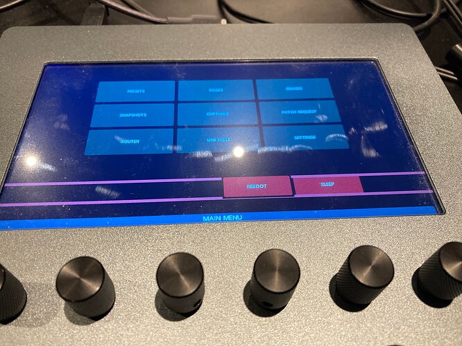

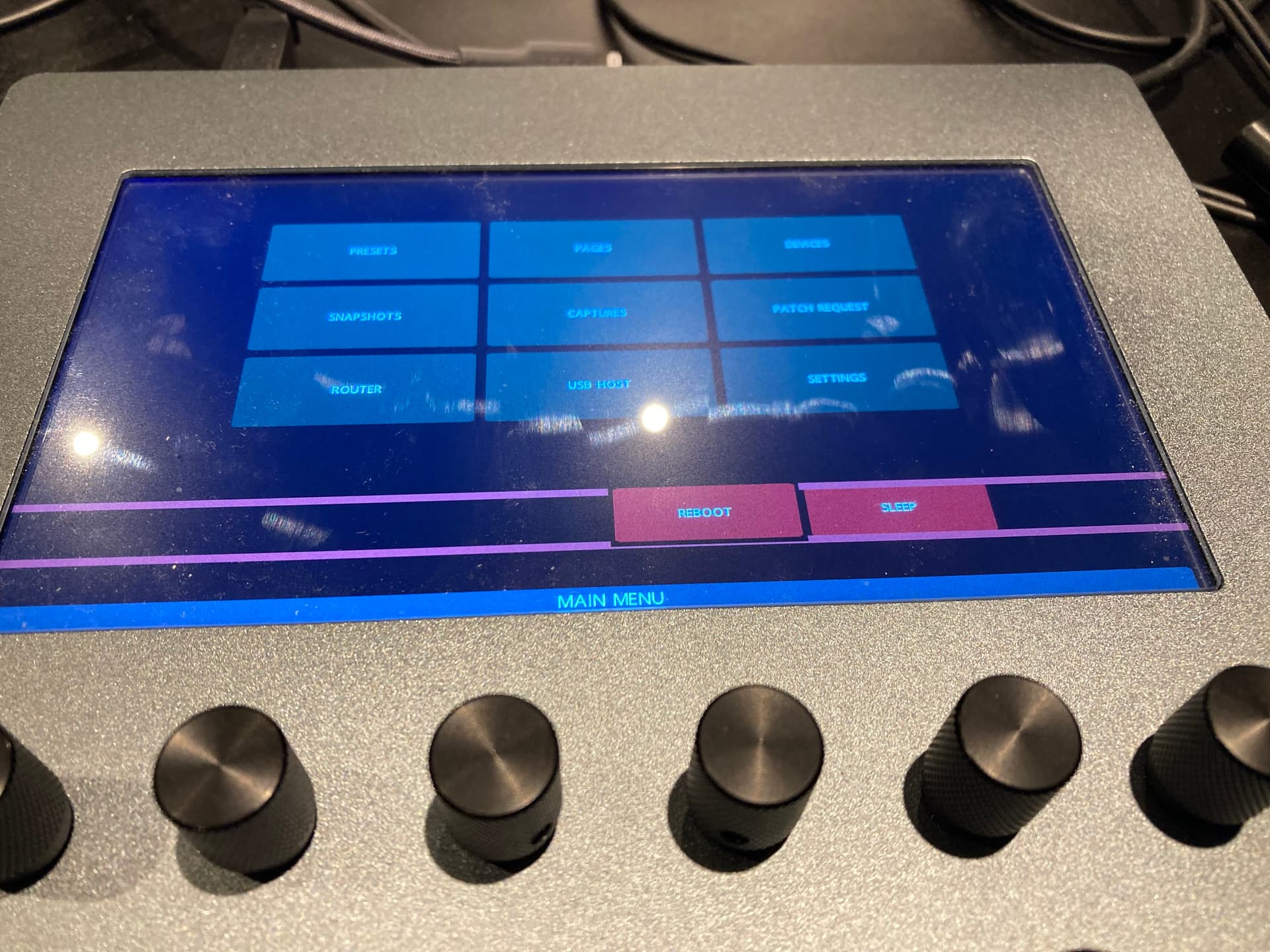

UPDATE: Now I have tried REBOOT and SLEEP with the red buttons. It doesn’t work. When I try, two horizontal lines are drawn but nothing else happens :pensive_face:
UPDATE: Ok, I understand now that you have to hold the button down for a while (nice feature), but why do the red lines appear?
yes, you need to hold the buttons for a while now - until the animations is completed. The extra bars are strange and should not be there. Do they stay there if you quite the menu and come back. And do they stay there when you reboot the controller?

I’m at work right now so I can’t test everything but I can at least say that they’re not there if I reboot Electra. As soon as I touch any of the red buttons the lines come up.
