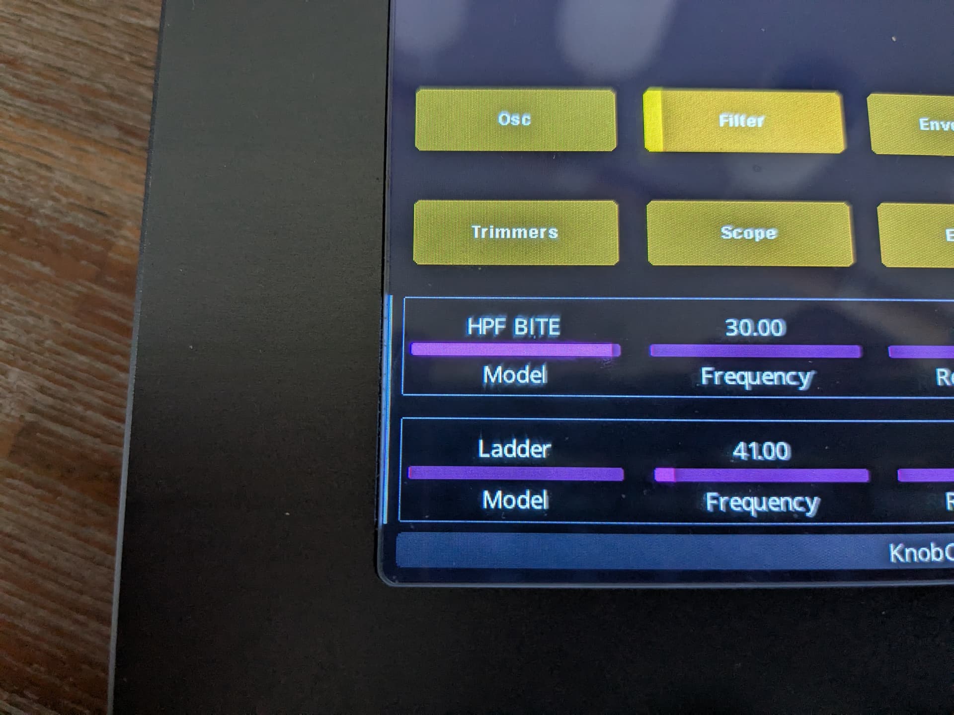

There’s a font rendering issue with BITE (see white pixels below the I char, that’s not dust):
Also, similar issue rendering post (see white pixels right of the t char):
