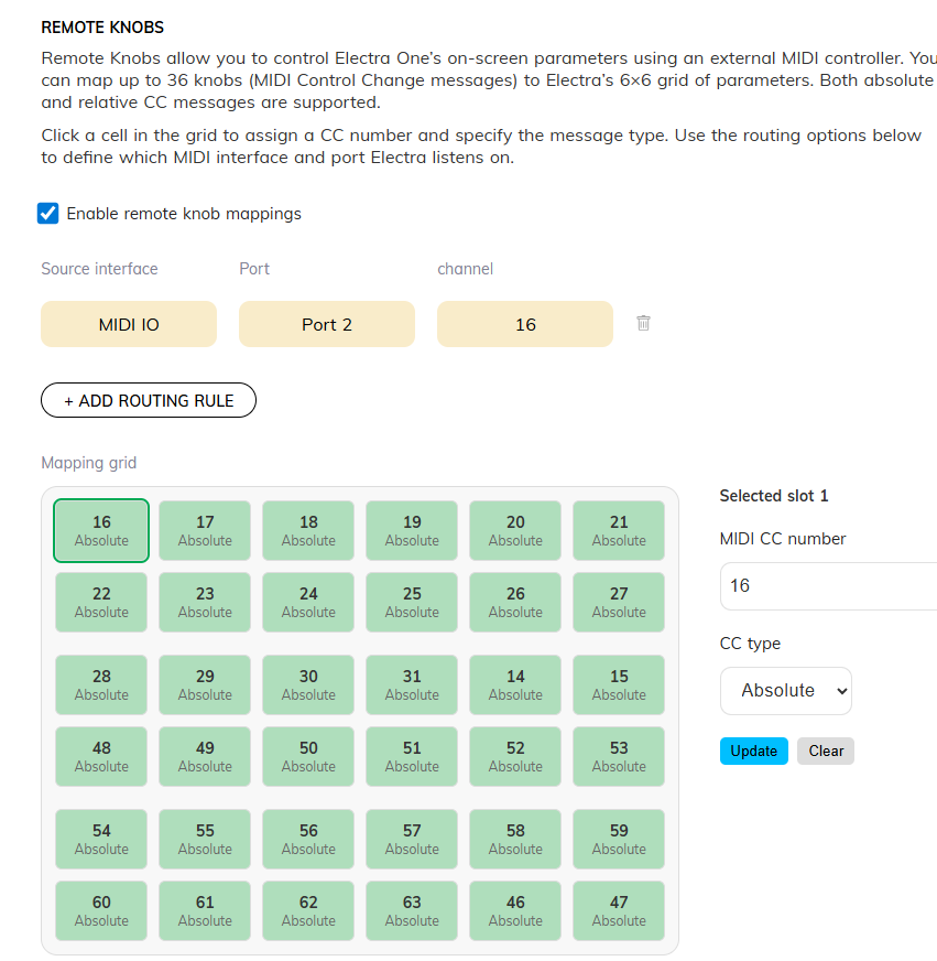

Not sure this is due to the beta version: I’m hooking up the old Behringer BCR2000 as remote buttons via DIN MIDI port 2. Bidirectional controls works but only with a workaround:

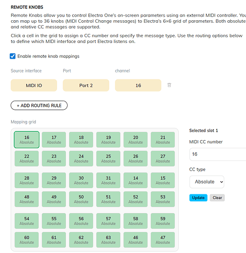

Here’s the setup as seen on the browser:
However when applied, only the direction BCR2000 => E1 works.
When looking at the settings on the E1 itself: Remote Knobs > Outgoing, the Parameter “Remote Oubound Interface” is on “Not assigned”.
After setting this to MIDI IO + Port 2 + Channel 16, bidirectional comms are established.
These settings seem to be retained in memory, as long as I do not apply any controller changes through the browser at which point they are lost on the E1.
However, when applying control changes via the touchscreen instead of via the encoder knobs, no signal is sent out to DIN MIDI port 2
Same with applying patch parsing or changing pages on the E1: the controls settings should be sent to the remote knobs to sync them.

I am having problems with this one. I configured my E1 in the same way as you did and the Remote messages seem to be sent out just fine when I use the touch screen. Are you sure it does not work for you?
I’ll recheck, Martin

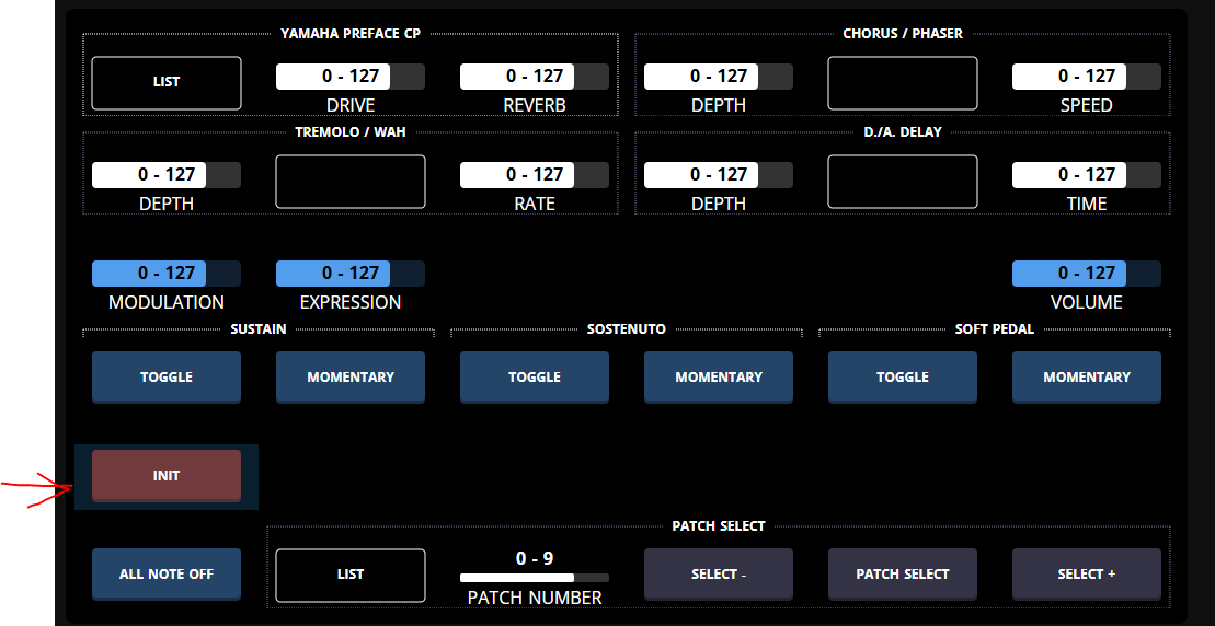

Other observation : a refresh issue. In this Reface preset Electra One App, there is an init pad (control 44) that is supposed to become hidden once applied. Only it doesn’t, until after you refreshed the page.

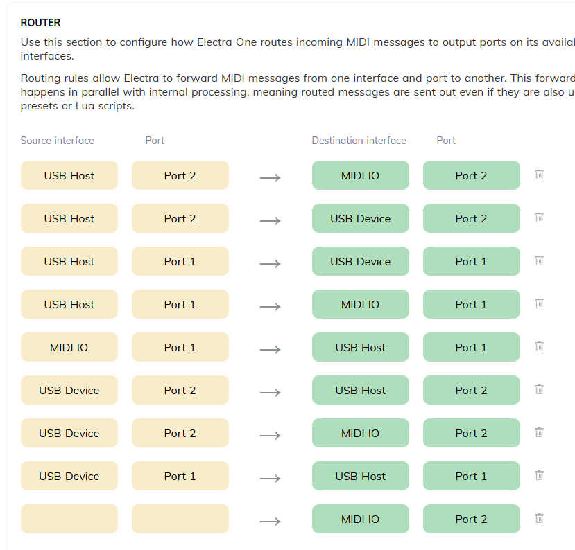

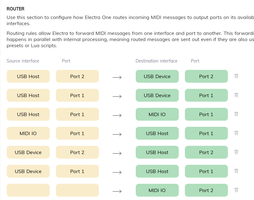

Maybe routing is incorrect?
I don’t recall having set up the last line in particular:
I then deleted all routes to MIDI Port 2, except the last one. But it didn’t help.

@NewIgnis @jhh control visibility issues introduced in 4.0.2a were resolved
