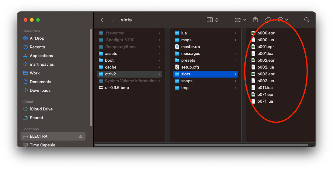

an infinite loop in the timer can be tricky. The reason is that timer.onTick() runs with a very high priority. If it does not “leave”, other things like buttons, touch, just keep waiting. I am trying to find some way how to make this more error-prone.
for now, restart E1 to the bootloader mode. (bottom-right button pressed) when powering the controller on. In bootloader, enable the USB Disk mode. USB storage device Electra will show up on your computer. Go to the ctrlv2/slots directory and remove the preset / lua files:
If you know what preset slot the preset sits in, you can delete just that specific .epr and .lua files.

Hi martin,
I was able to start the system by following this procedure.
https://docs.electra.one/troubleshooting/defaultpreset.html
Thank you.
