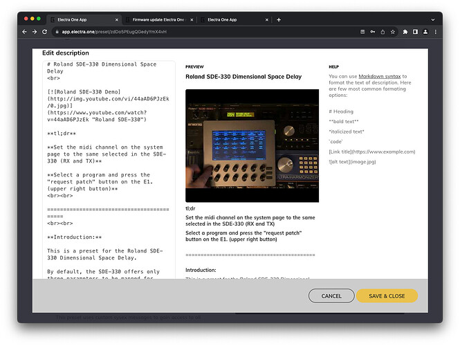

If you or anybody else wanted to include the video on the Preset Description page in app.electra.one, this is the way to do that:
[![Text to display if image does not work](http://img.youtube.com/vi/YOUTUBE_VIDEO_ID/0.jpg)](https://www.youtube.com/watch?v=YOUTUBE_VIDEO_ID "Link  description")
in your case it translates to:
[![Roland SDE-330 Demo](http://img.youtube.com/vi/44aAD6PJzEk/0.jpg)](https://www.youtube.com/watch?v=44aAD6PJzEk "Roland SDE-330")
PS: I used a copy of your preset to demostrate it :slight_smile:
