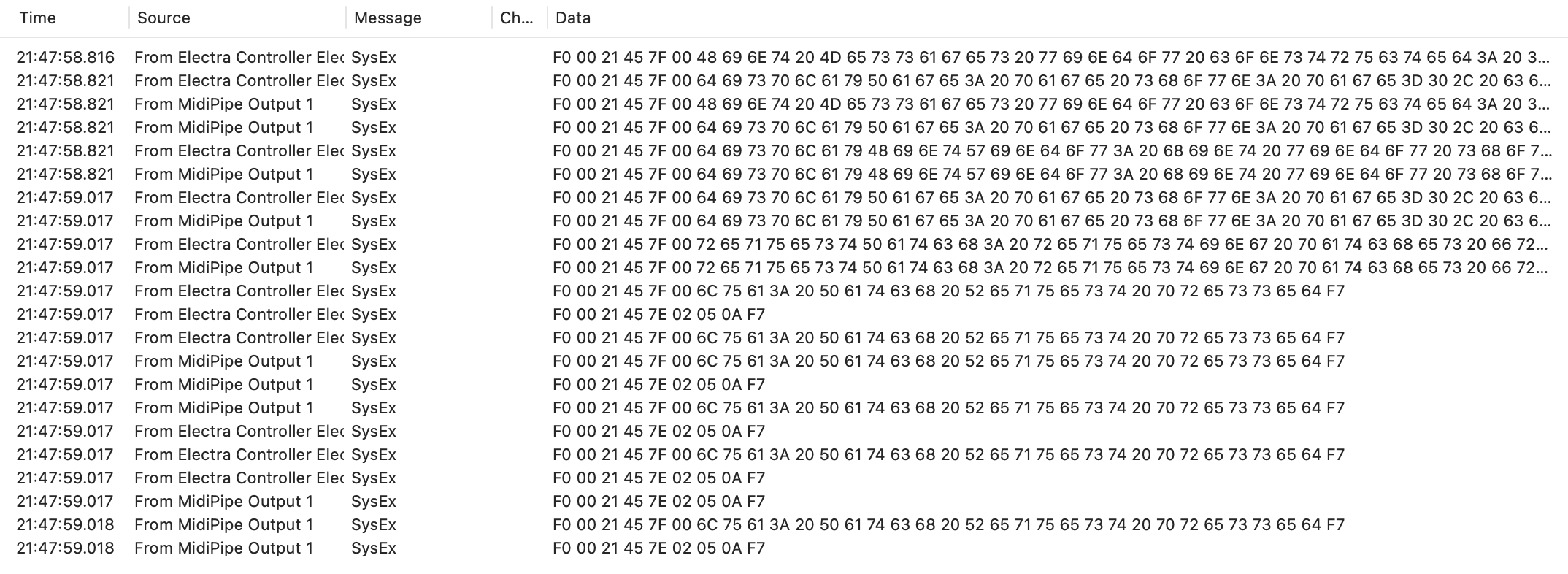

When defining patch.onRequest() to send a MIDI message when the PATCH REQUEST button is pressed, this message is sent three times in succesion. See attached screenshot.
With:

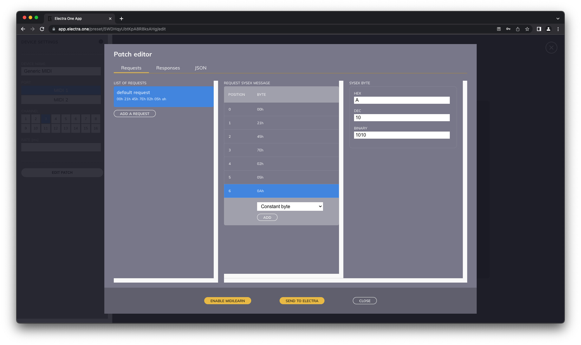

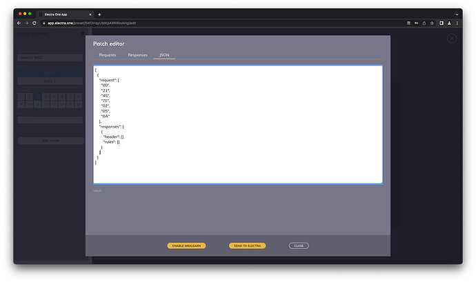

I assume your preset has three devices used. That means that the function will be called three times, each time having different device reference passed as a parameter. It is actually correct behaviour. You can either use the device parameter to identify the request. Or, if you just want to sent a fixed SysEx message (like in your example), you can define that message on the Device :: Edit Patch :: Request:
