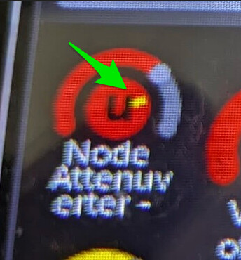

There are some good examples on existing MIDI controllers for UX to show the position of the actual incoming MIDI CC vs the position of the control, so you can see where you need to move the pot or fader before you can take over the movement again. Here’s how the 4ms Metamodule shows the physical position of its control knobs vs the logical value of the controlleed parameter for its “knob pickup mode”:
