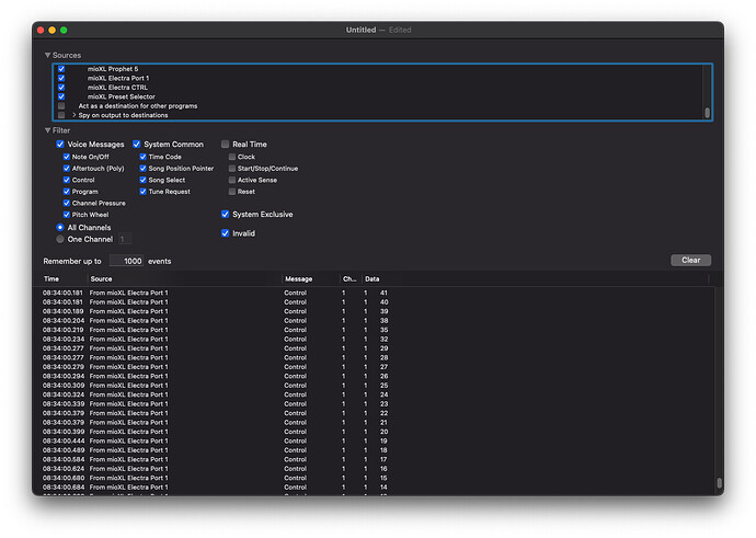

This will give you the communication in both directions. You can now send and receive MIDI messages to and from Electra via the ‘Electra Port 1’ MIDI port on your computer, eg. in Ableton.
Below is a screenshot from MIDI Monitor
