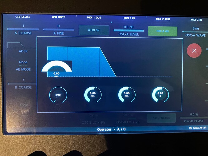

Also I see erratic ADSR behaviour. When the popup opens, all 4 pots control the first parameter, i.e. Attack. Value updates (sent using sysex command 0x14, 0x0E) also behave weird. The redraw for the first control is larger and above the actual control:
And the other 4 3 controls get string values that are not sent by Ableton
I noticed the wrong assignment of the on-screen knobs to physical knobs already. I have it on my todo list. The broken graphics is weird. I will look at that.
