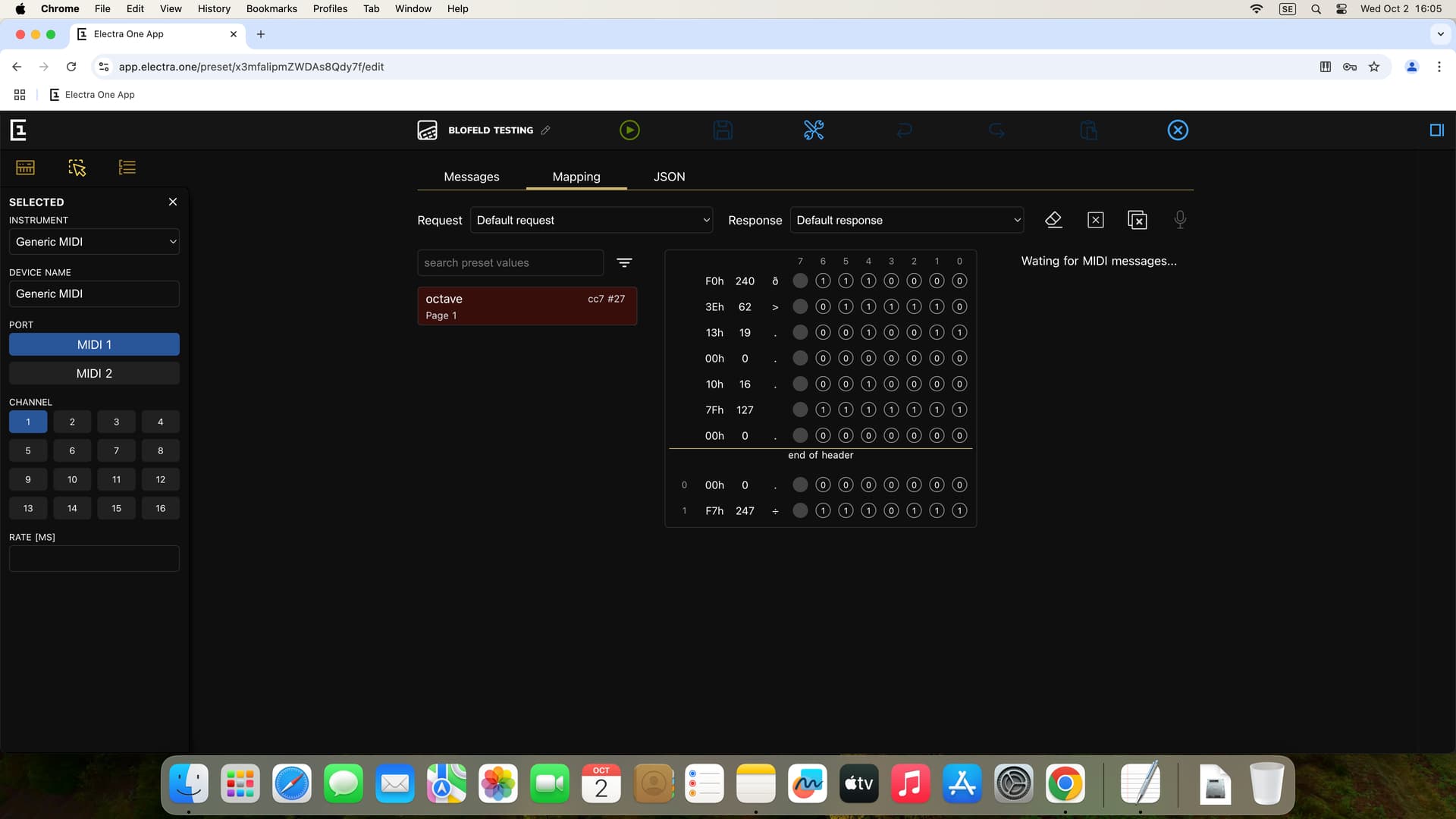

First of all. What kind of computer do I use? It’s a Mac mini M1 with 16GB of ram. I just did a clean install (2 hours ago) with Sonoma version 14.7 Then I installed Chrome version 129.0.6668.90 (Official Build) (arm64). It’s the only thing on my computer right now. The first thing I do is delete all history in Chrome so I always start from scratch. I log in and the first thing that happens is this, see picture 1.

I exit and close Chrome. Then I open Chrome and try again. I don’t need to log in or connect Electra this time. I go to the sysex editor and here it stops working. I set Electra on listening (as usual) I no longer get a response when I request a dump. Picture 4.
It doesn’t matter what I do in this situation. I restart the computer and try again, it doesn’t work. I delete all history in Chrome, now I have to log in again. Now it works. Yesterday I also installed a MIDI monitor (snoize). There I see that Electra sends out a dump request and Blofeld responds, but Electra does not build a list.
