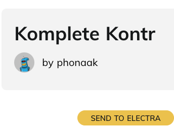

the “Komplete Kontrol” ccmap and epr files are displayed in the “dump” directory. I import the epr file into E1. the name of the preset will be “Komplete Kontr” for some reason. I change the color of a “controller”, send it to E1, everything is fine. I download the preset, change the name of the file again to “Komplete Kontrol”. I copy the “Komplete Kontrol.ccmap” file from the “dump” folder and the downloaded “Komplete Kontrol.epr” file to the Script “preloaded” folder.

Probably the reason is that the trick to get the name for a plug-in changed recently. The name is derived from the enclosing rack, but now an additional hyphen is added. Some “Komplete Kontrol” becomes “Komplete Kontrol-“.
does not work. after importing the dump file (why is the name of the preset not complete after import?) , I renamed the “Komplete Kontr” preset to “Komplete Kontrol-” with the E1 editor and downloaded it. I also renamed the “dumped” .ccmap file to “Komplete Kontrol-”. I copied both files to the “preloaded” folder, “makedevices”, restart,…unfortunately it doesn’t work.
