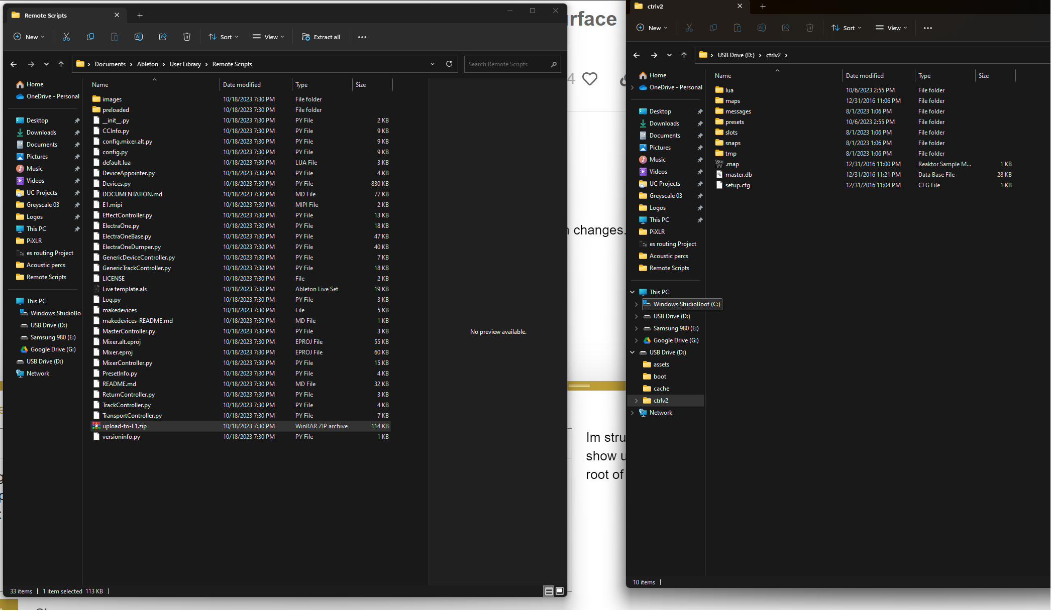

Im struggling to get this to work. Have followed the instructions on the github, but Electra One does not show up as a control surface in the midi settings. Does the āluaā folder in the āupload-to-E1.zipā go to the āctrlv2ā folder as the āpresetsā one does?

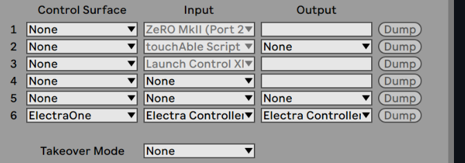

I think other connected midi interfaces and controllers messed up the communication between E1 and Live; shut off everyone (a motu midi xt, 16n faderbank and an MCL all connected through USB). I also tried using the Komplete Kontrol control surface preset, and I have control from the E1 to Live. The mappings donāt correspond however, which I assume is because of the mentioned control surface preset used, so Iāve been re-mapping. I suppose this would be unneccessary if I managed to install the E1 control surface preset as showed in the attached pic, from your installation guide?
Sorry to hear that. Yes, the lua folder also goes to the ctrlv2 folder , just as the presets folder. But that is not related to the Electra One not showing up as a control surface.
Not sure what you meen by re-mapping and the control surface preset. Things should work without any additional configuration once the ElectraOne is properly installed and recognised by Ableton and connected to the right ports as shown in the picture.
āElectraOneā is nowhere to be found in under the Control Surface menu, but the input/output is routed as it should, and ticked for āremoteā under midi ports.

If the ElectraOne is not found, then yes, no mapping whatsoever will take place. Where did you install the contents of the GitHub (i.e. not just the zipfile but all the files in https://github.com/xot/ElectraOne)? It appears Abelton cannot find them.
See the left part of the first pic a few posts up. My Documents, in the Ableton directory under user library/remote scripts (which was a folder I created, as per instructions)
Ah. There should be a directory ElectraOne within ~\Documents\Ableton\User Library\Remote Scripts that contains all the files.
