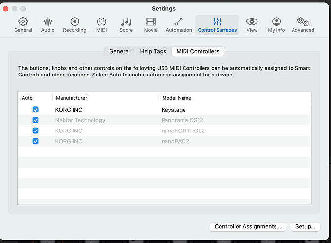

I wonder if the electra is properly connected with logic pro.
Because it does not appear in the list of available controllers.

I think this is caused by the fact that Electra One is not officially supported as a Control Surface in Logic Pro.
You can map the controls (both logic and plugins) manually using the Controller Assignments:
The automapping is currently available for Ableton @jhh, Bitwig @moss, and Reaper @moss, @Mint-Gecko by their Electra One integration scripts.
