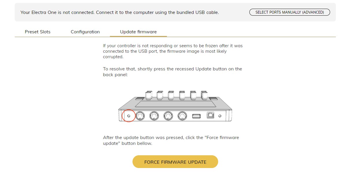

I had an issue . I would know how to force the firmware update (i guess as i read a lot on the forum)
Still i would love to know why it does not work in the straight forward way . Does it do that for you guys ?
Then first step :
Then i click on update
the second step :
I click on update
Here the windows make the usb disconnect sound a new window appear really fast and disappear as fast
then the windows connect sound again followed by
here i click “annuler” (“cancel” in english)
The force firmware appears but the electra is not recognized anymore

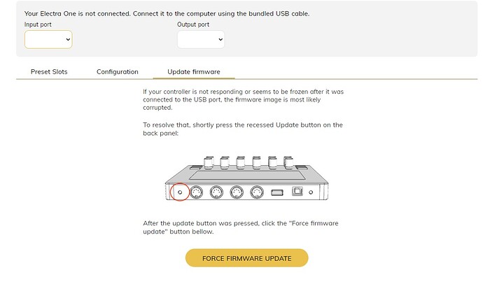

then i click on “select ports manually”
And there are no midi port to select .
I didn’t get further (i could)
Still i disconnect the E1 and reconnect it and it work again :grin:
You must allow the connection to the bootloader (Appareil inconnu 16C0:0478), ie. click on the “Appareil inconnu 16C0:0478” and then confirm with “Connexion”.
You cannot see the ports as your unit is in the firmware update mode. By cancelling the bootloader connection, you leave your controller in the update mode but the new firmware cannot be transferred to it.
