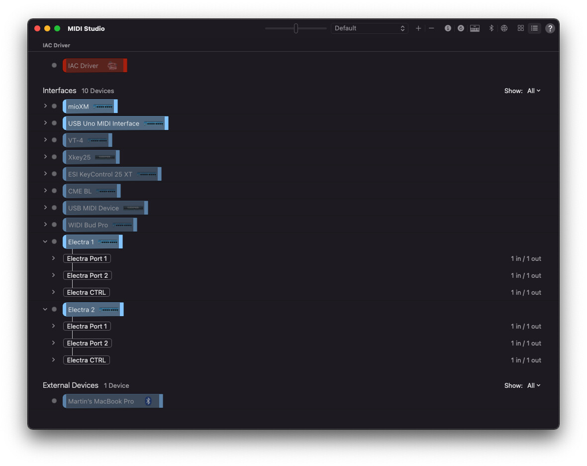

At this moment app.electra.one allows you to pick the ports. That means that if you give the second electra a different name (in Audio Midi Setup), you can use two tabs in the browser, each connected to particular electra.
Midi Studio in Audio Midi Setup:

Please note, you can use two Electras in two tabs even if you do not use different names. In such case, the you will see duplicate entries in the list of ports and you have to pick the correct ones…
