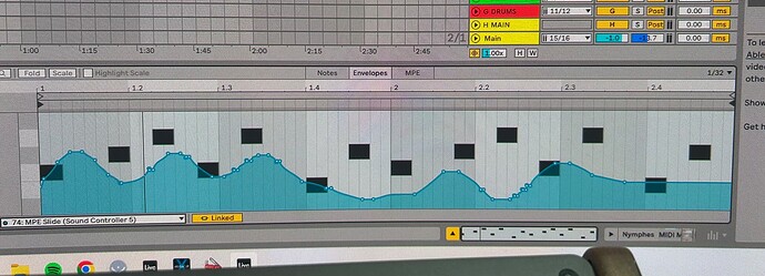

Hi folks. I am experiencing a strange thing. I am sending a basic envelope of CCs from ableton 12 on Win11.
The E1 mk2 receive the CC on a mapped controller. If I let ableton plays for a minute or so, the E1 screen starts glitching randomly but is not freezing. I have to refresh the screen (let say going to the preset page and come back) for the glitches to disappear. Then it comes back again and again, like if E1 can’t handle the flow of CCs.
any idea? I almost tried every thing and it is a very basic configuration with a preset containing only one cutoff controller…
