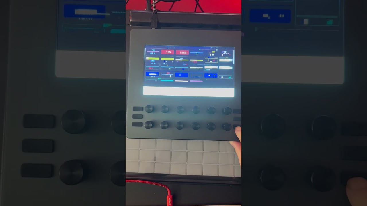

E1 powered up, and the display was unreadable. It’s been running newignis’s Minitaur template for a while. I did recently update to 4.1.1. I saw some occasional graphical glitches with various templates in the past, but nothing as extreme as this. It eventually reboots itself and all is fine.
Does the E1 store logs anywhere that might be interesting to diagnose ?
Hi, there should not be any glitches. From the video you shared it looks like that the communication between the mainboard and the display board gets occasionally corrupted. That may result in smaller or intense glitches, depending on when it happens.
I will send you a PM, I am quite sure you will need your display board replaced.
