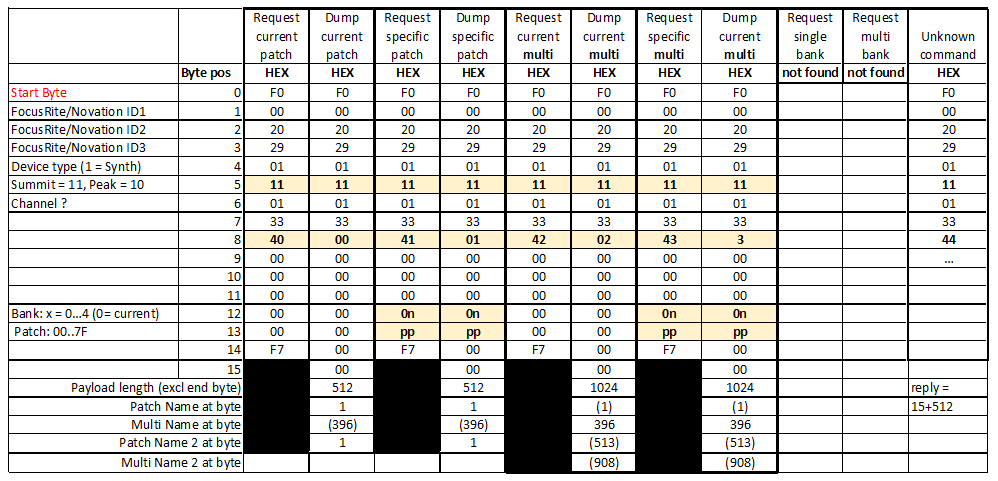

Hi David, just to let you know i’ve started the Summit patch parsing.
Attached is Work In Progres
Novation Summit SysEx composition V0.1.pdf (406.6 KB)
This is the first usable and complete version for a monotimbral Novation SysEx Patch response.
Any corrections, additions are more than welcome.
Next step: figure out exactly how the different response types (single patch, multi patch, request a bank at once), and how names are dealt with ( a multi patch seems to have 3 or 4 names inherently to itself).
Probably the patch parsing will therefor have to be done via lua, so all parsing logic can be reused for the different sysEx responses.
I’m also planning to read out all 8 banks at once, to instantly recall the patch names on the E1.
EDIT= I forgot to upload the doc: :wink:
Novation Summit SysEx composition V1.pdf (393.9 KB)
I’ve found a set of sysEx requests that work with Summit, and I expect the monotimbral requests should equally work with Peak.
However I could not find a sysEx instruction for requesting whole banks at once.
I did find another request the Summit responds to, but no idea what it is for.
If someone would find out more, do let me know.
I managed to load all 128 patch Names from a full bank into the E1. However when requesting MIDI sysEx responses from the Novation Summit, other MIDI data streams seem to cut the Novation response short: the response still ends on F7, but the length is shortened.
So I have to be careful not to play while the names are being retrieved.
Anyone else can confirm that behavior ?
