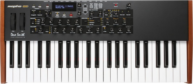

New version “Mopho V3” for this preset. It is now capable of handling both the Mopho Desktop and the Mopho SE keyboard version.
To that end it has a double response on the sysEx patch request (parameters are set differently according to the model).
Let me know if there are issues with it.
